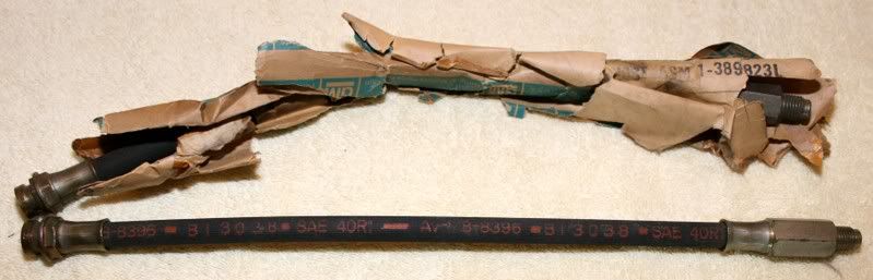

                Just a matter of opinion I believe this hose, which I would refer to as a single crimp, would be the assembly line hose (at least for the fronts) for 1967 and up to at least 72. The part number is verified in the 1969 A. I. M.

                  That's interesting Mark.
                  I didn't want to say anything because 67 was supposed to be the first year of the double crimp but my original 69 hose's crimps look just like your's with only the one crimp.

                    Anyone have a 67 or any other AIM through 72? Check the part number on the front brake hose. 3898231?

                      Re: When did double crimp brake hoses become required?
                      69 AIM shows a 3898231.
                        1970 AIM shows 3898231 - UPC5, Sheet B1 for the fronts
                          The 71 AIM still calls for 3898231.
                              67 AIM Front 3898231 and rear 3878958
