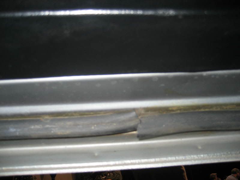

        • Erik S.
          • January 1, 2005
          • 407
          Re: 1972 door weather strip
          Jerry - I have a fairly detailed picture that I took during this year's judging retreat in Dallas when I was judging the 71 LS6, which received all the relevant survivor awards. I will post it later today as I have it on another computer.
          Erik

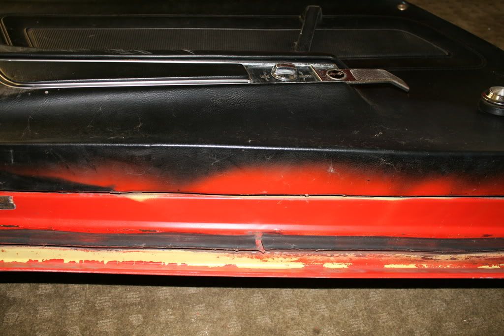

              • Tom L.
                • May 7, 2007
                • 438
                How do like the fancy paint job?
                Although the paint job is disgraceful, the weather strip and the gap appear to be original.
                • Erik S.
                  • January 1, 2005
                  • 407
                  here's the pic as promised - 71 LS6 drivers side door.
                  Erik
