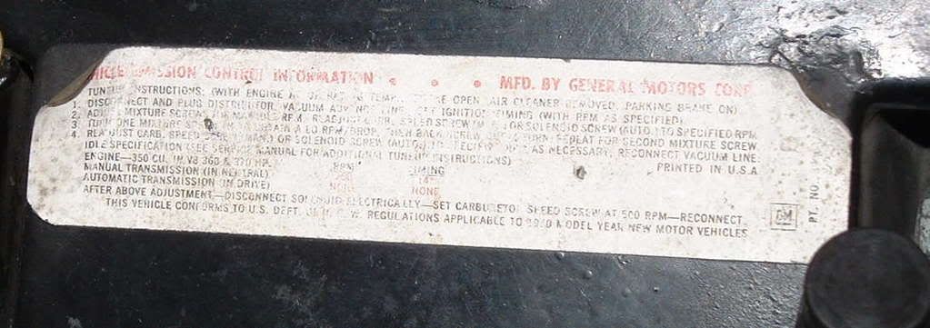

              Re: Sticker under hood 1970 LT-1
              Here's a picture of the emissions label from my 70 LT-1.
