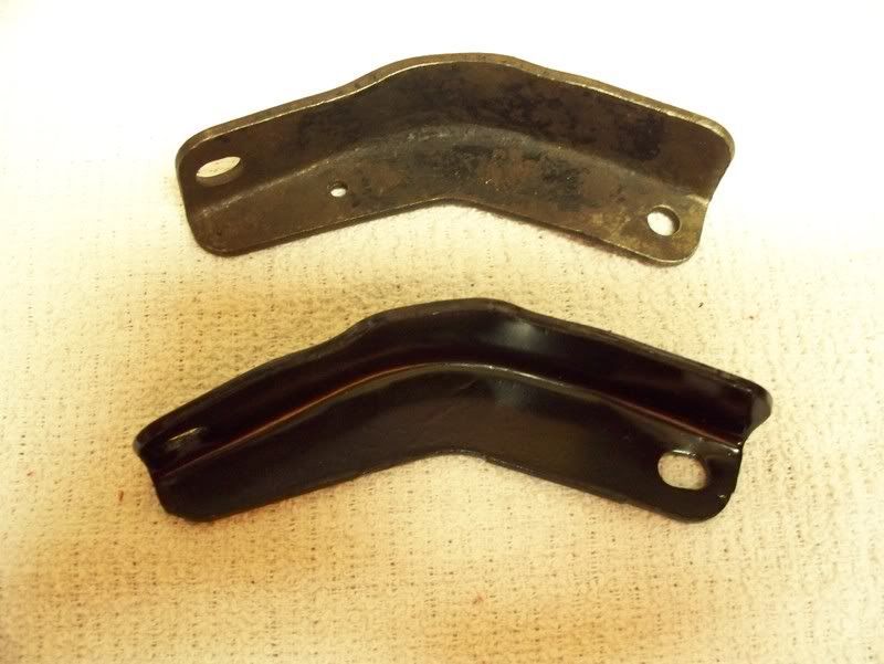

                          • Harry S.
                            • July 31, 2002
                            • 5332
                            #43
                            Re: '66 Starter brace alignment issue
                            I believe the bottom brace is a 63 brace and the top is a 64+ brace.
                            Harry

                                #45
                                Harry, Thanks for the pictures but I am still not certain that is correct. Below is a photo of a very original 63 showing the brace and bolt. Note a hole in the brace next to where the block mounting hole is. This is what my 63 brace looks like also, and it does not narrow at the top by the block. Your top brace looks like the brace I purchased in Carlisle and it's too short. This picture is upside down but you can see what I am talking about.
