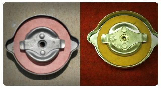

            53 to 57 left is original round rivets/right is repro flat rivets

                53-57 I pic'ed was a vented gas cap later the gas tanks were vented not really needing a vented cap.
