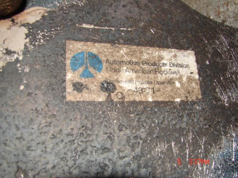

          Stan, Is there any chance that you could post a piture of this? I will agree with you about the knowledge of this board. Rare is it that I am not pointed in the correct direction.

            Re: '72 spare tire carrier decal
            As posted above, here is a picture of the decal/label found in the rear wheel well of my 72. Looks like it has 49810 stamped on it and 43 71 printed on it. The car has a Nov 11 71 build date. Hope this helps.
            Kevin
            • Paul O.
              • August 31, 1990
              • 1716
              That reads 43-71 or 43rd week of 1971. Paul
              • Jack H.
                • April 1, 1990
                • 9906
                Yep, those Rockwell labels, embedded in the fiberglass, are pretty well known. My '71 has them visible in the spare tire tub, the front nose panel, the fenders, Etc. The XX number prior to the year can't be month/day or the Julian day of the year as that interpretation makes no sense based on the build dates of various cars I've seen them on. The rational interpretation is the sequence represents the week of the year that panel went through the press mold....
                  Here is the tag off of my late '71 tire tub.
