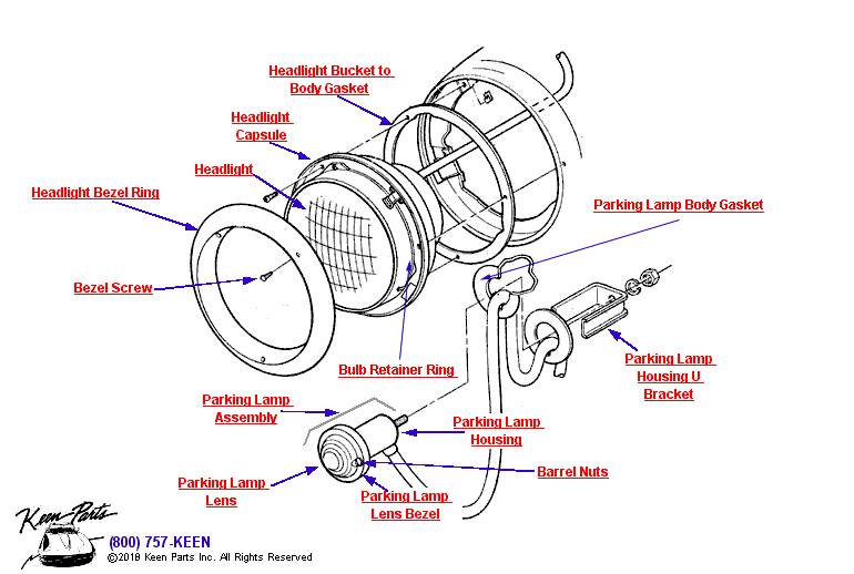

    My 56 is a very early vin number and the headlight rings the hold the bulb in place do not have any tabs to hold bulb in place. After looking at corvette central I see you can buy these types of rings but I don't understand what holds them in place. It has been apart for many years.

      Yes I have the bulb retainer rings, which don't have any tabs like later years to screw them to the headlight capsule. That's what I find puzzling. At first I just thought the tabs had fallen off but there is no spot for them to screw onto capsule even if there were tabs.

        A solution might be to use the later year rings and tap them into the capsule. These rings changed late in 56 to the 57 models.

            Does your ring have a tab and a spring? The tab goes into a slot and the spring attaches to a hole.

              Yes there is a tab sticking out of the capsule on one side. Ill go have a closer look

                Thanks for info Mark. Yes the tab was there and the spring and it all makes sense now,
