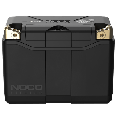

                      I have removed the gel battery from inside two different restoration batteries, and replaced them with the NOCO NLP20 (C1) and NLP30 (C3):
                      Meet the NOCO Lithium NLP20 12V Lithium Powersports Battery, a Group 20 battery, rated at 7Ah (89Wh) and 600-amps of starting power. It's better than lead-acid motorcycle batteries in almost every way: no sulfation, no activation, no acid, no maintenance, no water needed, and it comes fully charged and ready to install. It's designed to withstand 50,000 start cycles and 2,000 charge cycles, making it the highest performing and longest-lasting battery for any motorcycle, ATV, UTV, PWC, scooter, or snowmobile. Its internal Battery Management System (BMS) ensures safe and reliable operation without requiring any manual reset of its BMS. And unleash the power of lithium and quickly recharge within minutes - even from 0% to starting with just 5-minutes of charge. Compatible with most powersports brands - Aprilla, BMW, Buell, Ducati, Harley-Davidson, Indian, Triumph, KTM, Argo, Can-Am, Honda, Husqvarna, Kawasaki, Suzuki, Arctic Cat, BRP, Waverunner, Polaris, Vespa - motorcycles, ATVs, UTVs, PWCs, quads, 4 wheelers, jet skis, seadoos, waverunners, scooters, riding lawn mowers, generators and more. Plus, it replaces lead-acid motorcycle models: B16L-B, B16CL-B, B18L-A, BTX15L, BTX15L-BS, BTX20L, BTX20LBS, BTZ20L, BTX20HL-BS, B50-N18L-A3, ETX16, ETX16L, ETX20L, GYZ20L, GYZ20HL, YTX15L, YTX15L-BS, YB16HL-A-CX, YB16L-B, YB16CL-B, SYB16L-B, YTX20HL, YIX20HL, YTX20HL-PW, YTX20HL-BS, YTX20HL-BS-PW, YIX20HL-BS, YTX20L, YTX20L-BS, and Y50-N18L-A3. Includes: NLP20 Group 20 7Ah Lithium Powersports Battery, (2) 3-Way Battery Terminals with (4) M6 Hex Screws, (1) Hex Key, (1) Removable Mounting Bracket, (1) 12mm Spacer, (3) 15mm Spacer, User Guide, and a 5-Year Limited Warranty.
                      Pictured below are the red-topped one I removed, and the NOCO I added. I did have to cut the bottom of both cases to remove the battery as the red-topped ones are molded in place using tar and plastic.
                      So far both have worked well for me.
                      The benefit in a C3 is that the lithium battery is so light that the whole case can be installed in the back of the car using 2 fingers.
                      Try that with a lead acid battery.
                      I did also buy NOCO chargers for each one, and use their Lithium setting.

                            The 30 fit in the later case because, as you see in the photos, I was able to remove the top and get full measurements.
                            I put the 20 in a DC-12 to be absolutely sure it would fit.
                            The 30 may have, but I didn't want to chance it.

                                I decided to use the a-z speed return policy and price control to get both
                                huge difference in size for 100cca
                                30 is to tough wrestle in there
                                snapped a brass post off resuming intent to get the 30 in there
                                terminals end up on bottom when keeping cables shorter
                                tose posts are right at the bottom so a frp isolator essential to prevent grounding out
                                not done yet, had the post not snapped, I would have put the 20 in and called it a day
                                Now I’m looking for flat lugs on the weekend that will bypass the posts
