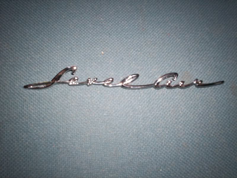

                              Re: Strange heads 3731539 any suggestions
                              Ed,
                              That is correct. The 58-59 pass cars were available with the Air Ride susp (it was called Level Air). Thus, those cars had heads with threaded holes in the ends of the heads. Also, BIG trucks with air brakes had heads with holes for mounting the air compressor.
                              There was an emblem on the trunk.
