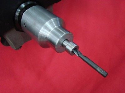

                        I agree with Joe Lucia that drilling the crank with the engine in the car is not ideal. However, several years ago I wanted to drill and tap the 300 hp crank in my '67, but the engine was in the car and I had no other reason to remove the engine.
                        I made a simple drill guide out of a block of hardwood with a 1.25" hole in one end (cut using a Forstner bit) to fit over the crank snout, and a 1/8" hole in the other end to fit over a long 1/8" drill for making a pilot hole. After the pilot hole was drilled, I enlarged the 1/8" guide hole to the 25/64" size for a 7/16" tap, and then drilled the crank with the larger drill. After that I used a tapered tap to cut the threads.
                        Recently I learned from a friend that there are two available fixtures kits that use a similar approach:
                        Use this tool to help drill the snout of cranks on 194 230 250 engines. Also works on SBC 283 327 as well for 235 261 The cranks are not drilled from the factory and adding the 7/16 bolt hole will aid you on installation of the balancer and retention of it. Precision made to fit on the end of the crank. The fillings drop out the side while drilling. A drill bushing is used for perfect alignment of the drill during drilling. This procedure can be performed on a assembled engine. The tool will fit on the snout. Be sure to plug the seal hole with a rag and direct the slot to the down position for chip discharge.
                        283 and 327 CID Chevy Engines Crank Shaft drill and tap fixture tool kit 7/16 If your crankshaft is not out of the engine and can not be drilled and tapped in a crank shaft lath this very handy tool lets even the novice at home machinist precision drill and tap the crank shaft snout on the 283 and 327 Chevrolet inline
                        The only thing that I don't like about the first one is that it does not use a pilot hole, but an insert could easily be made to support the pilot hole drill. The forged crank material is fairly hard to drill, and I think the pilot hole helps with drilling the 25/64" hole.
                        The second one above uses a pilot hole but costs more.
