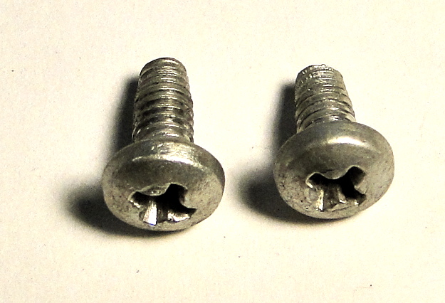

          See JM bolt chart, page 231:
          Ground Strap, 164352, Phillips Pan Head, 6-32 X 0.375, 57 only w/ large external tooth washer

              GM Standards lists #164352 as a type C Pan head cross recess tapping screw 8 - 32 x 5/16 cad or zinc
                Thanks for the info. I had a feeling it was a #8.
