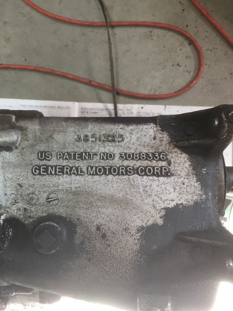

    until dad orders the 65 manual can you guys help me with his trans from his new 65 L76 project. the bell-housing (not pictured) is a 621. is that correct? the trans I can't find the vin stamp. and thinking it was replaced along the way. also why is there a pound sign (#) under the word General?

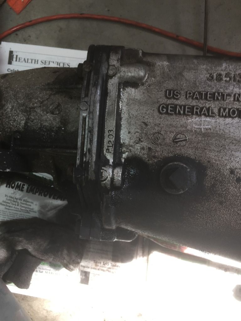

    also here is the picture showing the POP with the P0203 for the trans

      Bellhousing should be #3858403. The VIN should be stamped on the opposite side of the P1203.

                  The transmission is a 1965 model year trans. The "P1203" stamping appears to have been done with individual stamping dies. It's curious, though, that "P0302" appears on the booklet. Possibly, someone tried to duplicate that and added one character. It's also possible that the main case was replaced and someone stamped this sequence on it.

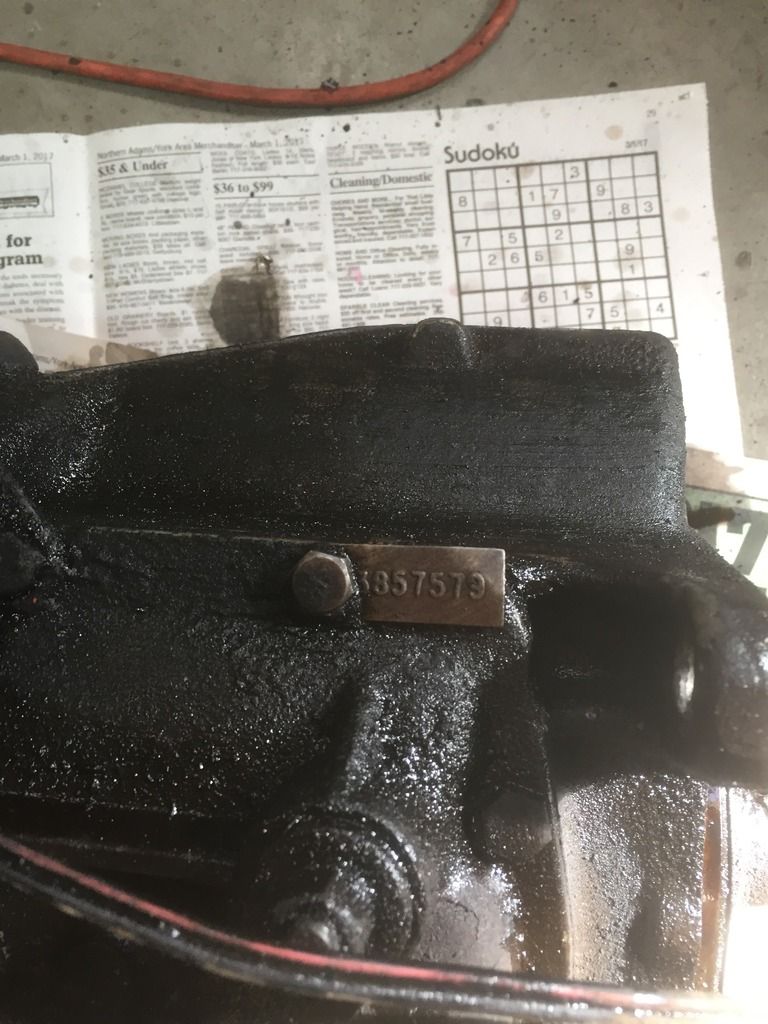

                    Tag # 3857579 indicates: 1st gear 2:20, 2nd gear 1:64, 3rd gear 1:28, reverse 2:27 trans has: clutch gear 3831766, counter gear 3831727, Speedometer drive gear 3708145, Should have: 1-2 shift lever 3864402, 3-4 shift lever 3864403, reverse lever 3846891
                    The stamped letter P indicates Muncie built 4 spd Passenger

                        Keith is there a Vin# on the opposite side of the date on the transmission?

                          Keith - I just looked at a pic of my 1965 Trans date. It is stamped the same way. Do not count that out as being the original trans for that car. Do some further investigation.

                            That's good question. I will have to degrease that side and look.
