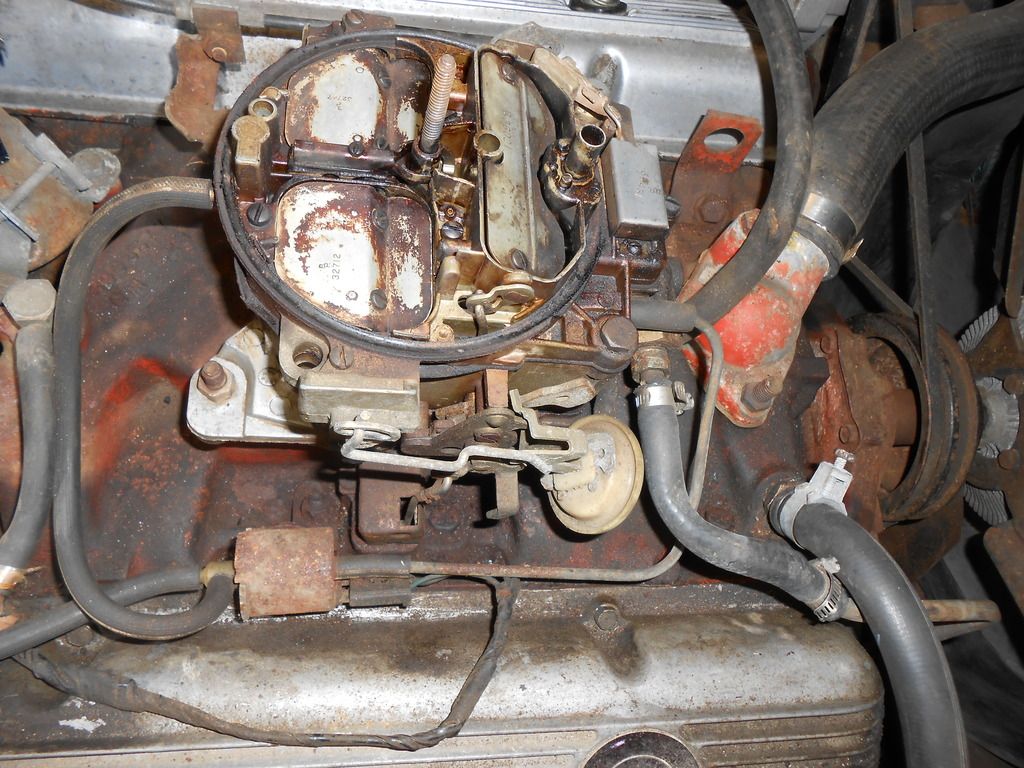

    i have a 1970 350-350 and would like to know the correct routing of the vacuum lines exiting the solenoid. thanks in advance

    A nice "unrestored" view. IF YOU CAN SEE IT. I CAN'T FIGURE OUT THIS PHOTOGRAPH STUFF. This will work to answer your question, but some other features are rougher than you might want.
    I'm going to see HAMILTON. You guys try to figure this out. I give up.
    Finally got it while SWMBO hollered about dinner being ready.

      Good picture of the TCS hoses Terry. The vacuum line from the rear of the TCS solenoid that can't be seen where it connects goes to the distributor's vacuum advance. I bought my 1970 Corvette new in August 1970 and by SEP 1970 the TCS was disconnected and a direct rubber vacuum line was installed direct from full time vacuum from the carb to the distributor vacuum advance canister. Gas mileage improved driving in the city and the engines temperature was reduced. It still not being used after over 46 years.

              FYI - Not that it matters much, but the 1970 AIM, UPC 6, Sheet C1, shows the TCS solenoid vacuum lines in the opposite positions as the photo above.
