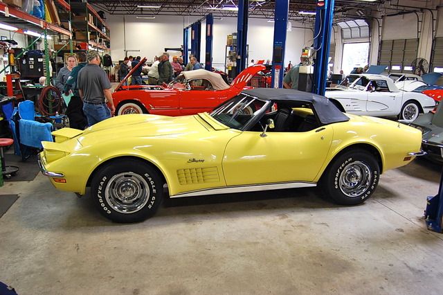

    Here's a photo of a very nice 70 350/350 that was brought for Flight Judging at the Delaware Valley Chapter's annual Fall event this past Sunday!
    If you weren't there you may want to mark your calendar for next year already. There's always a very nice turn out of cars to be Flight Judged.

      Re: 1970 Radiator Hose Clamp's
      70 L46 with AC. Very very nice and Daytona Yellow too!
      Bill

        Hi Bill,
        I think you would have enjoyed taking a look!!!!

              • 3415
              Hi Stephen,
              I understand you're pretty familiar with the car in the photo I posted!
              I didn't make the connection until Elaine sent me a message!!!!!
              It certainly is a beauty!!!!
