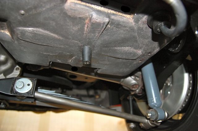

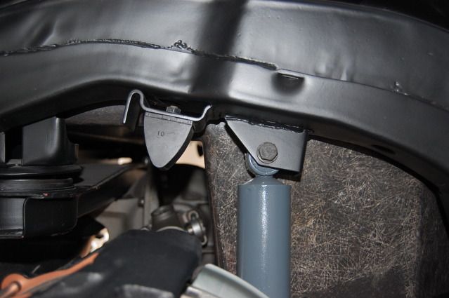

      The underbody fiberglass surface was used just the way it came out of the mold.
      Any paint… body color or blackout… would be in very limited amounts and areas.
      What you'll face is trying to do the repair in a way that mimics the dark, 'stranded', finish of the original fiberglass/resin.
      This is difficult to do and why repairs often have a little black sprayed on them to help conceal what was done.
      Here's an example of the appearance of the battery compartment bottom and jack compartment side.
      Good Luck!
