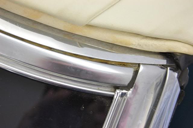

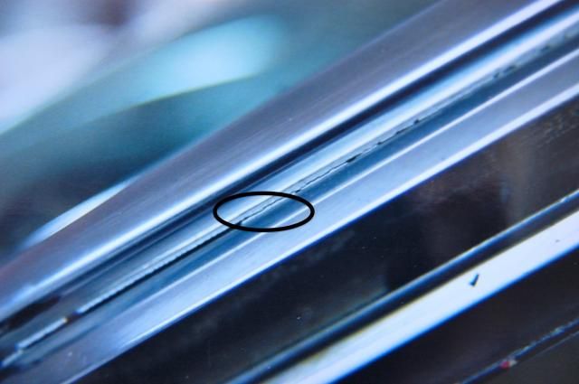

          Hi Mike,
          Here's a photo of the original sealer, a photo of some replaced sealer using 'Scribbles', and the product.
          I also found the same sealer on the a-pillar in the seam between the stainless reveal molding and the stainless weatherstrip retainer.
