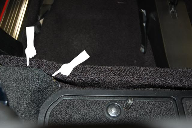

        I realized while working on the wheel well carpet on my 71 that the tendency may be to push the piece to far to the rear.
        The forward end of the carpet needs to extend a distance that is long enough for it to be tucked down between the back side of the steel seat bulkhead and the forward end of the fiberglass wheel well. I'd say as much as an inch of it may disappear between the two.
        Perhaps this might that help you with your installation?
        Left side looking forward.

          Re: Another 69 Carpet Question
          Thanks Alan for the advice. Looks like you have done a good job.
