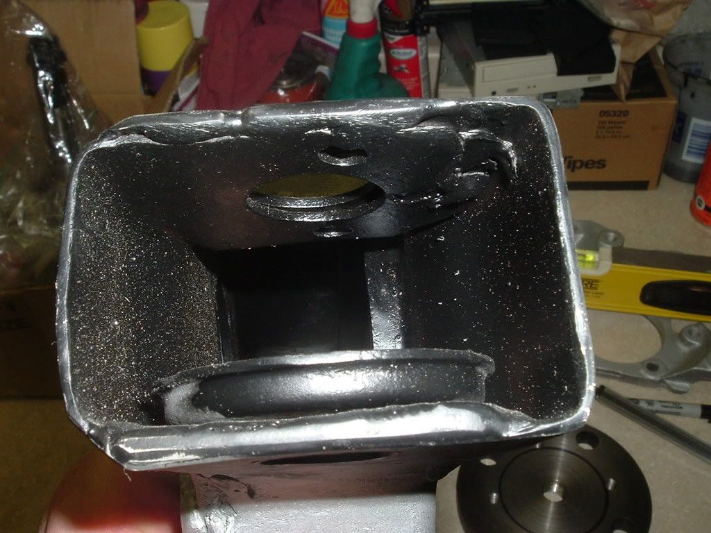

      Those holes were not on center with the large hole. I went through my files and this is the only one I found showing those holes, from inside the arm but you can see they are off center. I would lay out the rear bar from arm to arm and see how it fall. I have transferred the hole pattern on new arms by making a simple cardboard template.

          I see yours do but many I have seen are not on center. I wonder how they set those up?

            Thanks for the pictures everybody. I'm wondering if for 67, they were on center, and then on later on years, they went off center. If you look at Steve's pictures, the end link appears (it might just be the angle of the picture) to toe inward, or that might be that way if the wheel is jacked up. I know the real late models are off center (81-82). I'm wondering if the change occured when they went with the swaybar that had the bends in it to clear the tire carriers. Gary, do you know if the picture you have was for a pair of 67 trailing arms, or C3's? I really do appreciate your efforts!

                That particular arm was probably a C3 arm, you can see it was welded on the ends and the seams were all filled in. It was for a performance build.
                I would say most of the arms I see they are offset but I don't pay much attention to them to be honest. I should have plenty of 67 arm pictures I just have to check and see.
