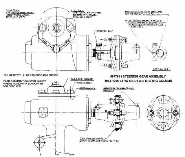

                          • Jim S.
                            • August 31, 2001
                            • 730
                            Re: Steering Wheel Alignment and High Point Centering
                            Just a point of information. The 1963 steering gear assembly was shipped from Saginaw with the flexible coupling assembly attached to the gear input shaft. The steering gear assembly drawing states the following: "Slot in coupling assembly to be aligned with mark on worm shaft at assembly of coupling to gear assembly." With the gear on-center, this would place the pinch bolt that attaches the coupling to the gear to be horizontal and passing over the 12 o'clock position. Since Saginaw made that connection the pinch bolt head was easily reached with a torque controlled wrench. This also placed the pinch bolt that attached the coupling to the steering column flange as vertical and passing through the 3 o'clock position. By leaning over the driver side fender, the St. Louis assembly worker could fairly easily reach the head of this bolt that was sticking straight up at him.
                            Jim
