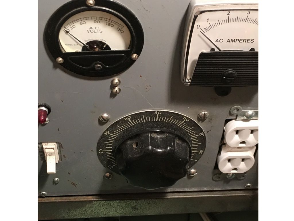

        To 100% condemn or vindicate the transformer, run the transformer primary only like Joe and I say. The best way to do this is to power it up with a variac. Also put your current meter in series with it. That way you can bring the voltage up slowly while monitoring the current draw. This will prevent you from 'cooking' the transformer if it really does have a short.
        If you don't have a variac you can put a resistor in series and measure the voltage drop across the resistor to determine and limit the current. A 100 ohm resistor will limit the current to 1.1 amp, but that's also 110 watts worst case. So start out with a higher value resistor to limit possible smoke. With no load the current should be very low. 1k ohm will limit you to 110mA and 12 watts max. If the current is more than a few mA, then you have confirmed that the transformer is toast.

              Dan,
              More great ideas!!!
              Rich,
              I have a variac chassis I built a while back for the very purpose Dan mentions. Would you like to borrow it? Here's a picture (using it is pretty self explanatory):
              If you would like to use it, please email me through the board.
              Good luck and may the force be with you!!!
              Joe
