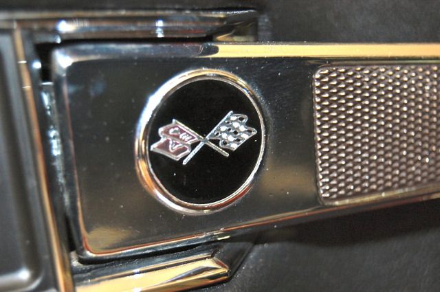

                I am not sure of the answer, how does the reproduction crossed flag emblem compare the the original?

                  I am curious about this as well... does anyone have a photo of a known original emblem? I have some of the reproductions, so I could post a comparison. I tend to think that the reproductions produced by Trim Parts, Inc. are actually a little "too nice" compared to the originals, but I have never seen a side-by-side comparison.

                    Here's an original from my 71.
                      Thanks, Alan! As I suspected, the reproduction emblem I have looks a little "too nice" compared to your original:
                      The checkered flag is much more well-defined on the reproduction.
                      - Paul

                        Paul------
                        These emblems get a lot of "rubbing" over time. The original when it was new may well have looked like the reproduction. For a real comparison you need to compare an old NOS handle to the reproduction. I'll bet you'll find they are quite close.

                          Re: Judging inner door handles on a '69
                          Hi Paul,
                          I guess my picture isn't a good example then.
                          I'm going to delete it and would like you to delete it from your 'quote' of my post too.
                          I'm sure someone will be along soon with a picture of a nos example.

                            Alan,
                            Yours is a great example of an original, no matter what age. Until someone posts an NOS example it's as good as we have in the thread and I would recommend leaving it up.
                            I have never seen a reason for you to remove a photo, because even if a thread takes a different turn your photos are so good that we all learn something from them. Each one has its own intrinsic educational value, and when removed that is lost.
                            So please, reconsider taking down photos after they've been posted to threads.
                            Patrick
