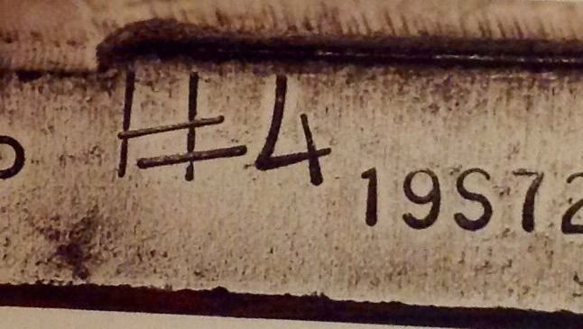

                        Here is a builder's mark on a 69 we judged, many years ago...
                        Kramden
