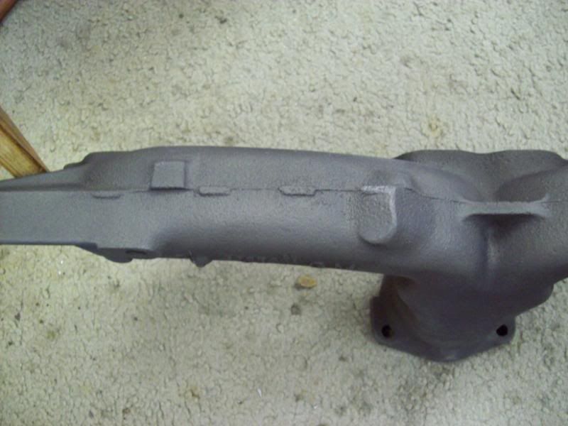

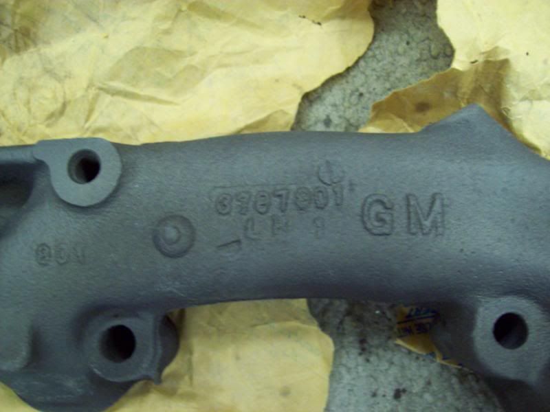

    These are original 2 1/2in manifolds which are on the SB400 in my 56. I had them coated by Coat Pro in Okla City----------------it's not ceramic, I don't know what it is. Of course, this is certainly not NCRS correct, BUT, my manifolds have been coated for several years and this is what they look like now.
    SORRY, this picture came out a little dark.

      I had my LS5's ceramic coated tungsten grey, and they have the exact finish as shown in the middle two pictures.
