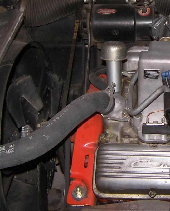

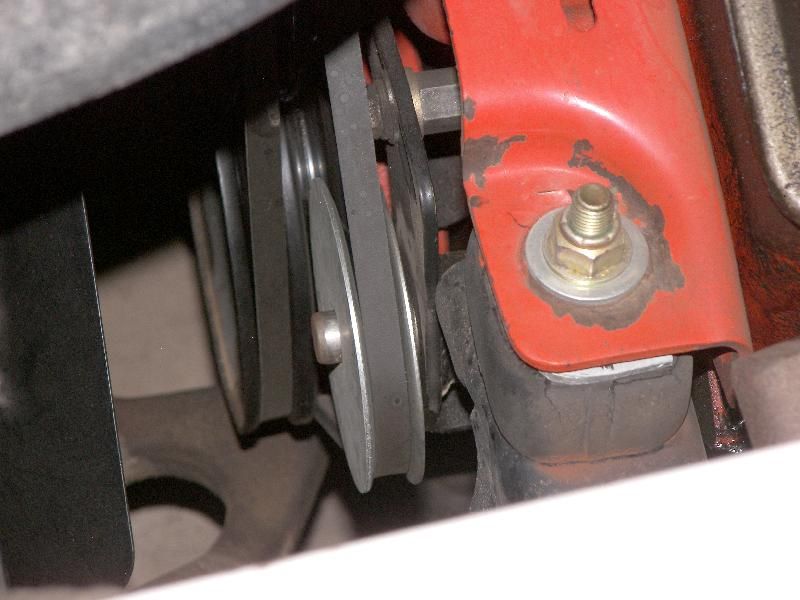

          Although not originally used on the solid axle Corvettes, I've decided the second/redundant water pump belt is a worthwhile addition to my '60.
          I used the idler pulley, deep groove crank and water pump pulleys from solid lifter Sting Ray engines, all of which are readily available. No issue at all getting the generator belt to align.
          The whole installation is "period plausible" and looks right at home:
                Jim
                Jim-------
                You can use the secondary pulley grooves without using an idler. However, it's a whole lot easier with the idler.

                  Jim-------
                  I did that on my '63 roadster in order to get a redundant water pump belt. Frankly, it was a PITA to install.
