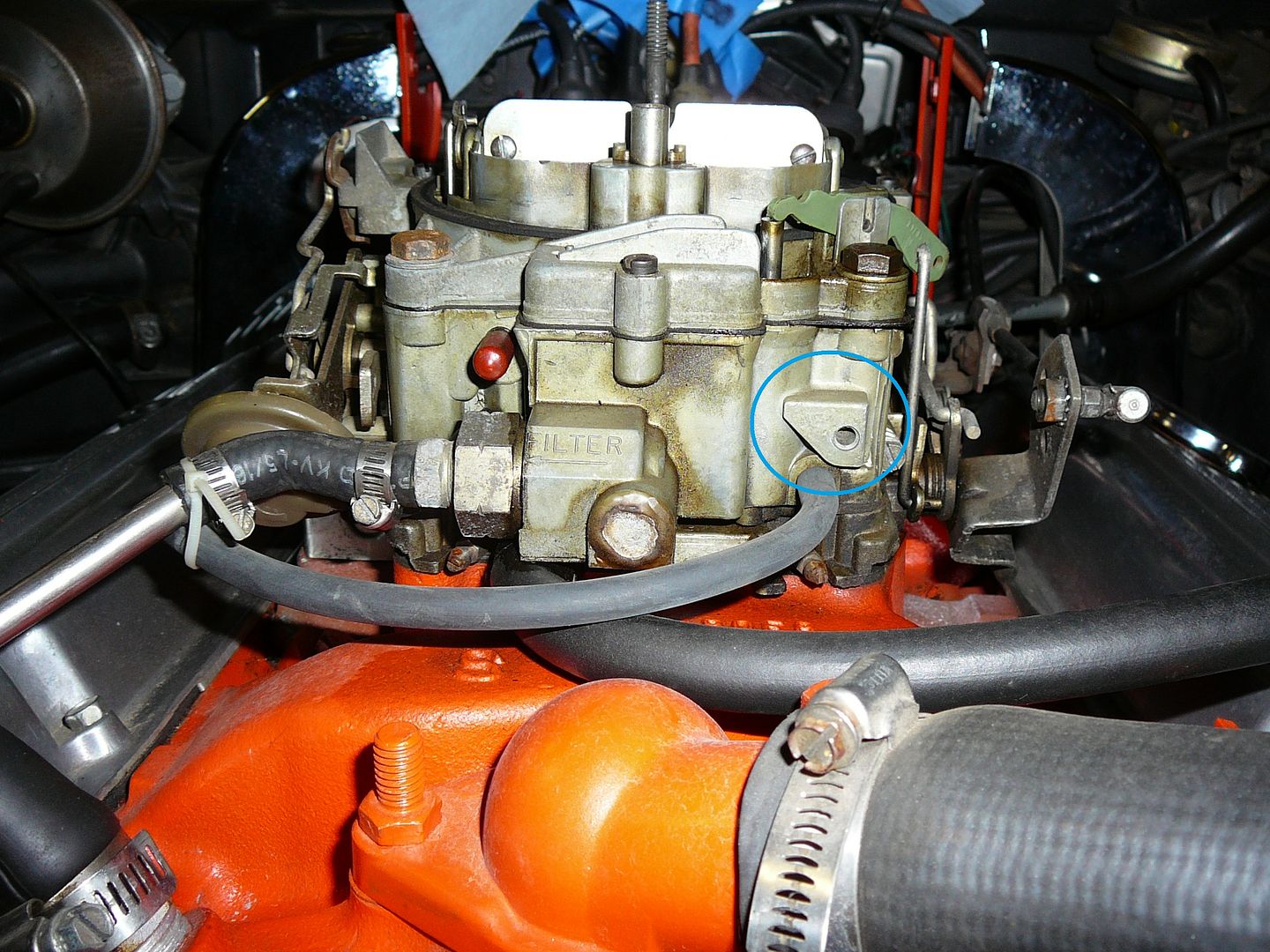

    It's most likely a service replacement carb, 156th day of 1974.
    Does it have a triangle casting on the front of it? If so, service replacement.

      Thanks Mike. Yes that casting is there and after more investigating I found the letters RP all over it. Reproduction?

            Mike Furline- Is that a photo of your car's engine? The rubber hose splice looks like a real fire hazard. Consider making it a priority to replace it with an original style steel line. The Vette parts houses sell pre-bent lines for your engine and they're not expensive.
              It was when I first bought it.
