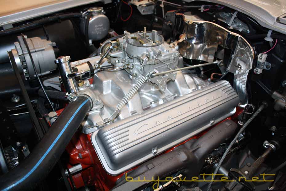

          Talk about not liking fuel hoses downstream of the fuel pump; what about 64 through 67's with Holley carbs? They all have fuel hoses from the factory from the filter to the carb.Stu Fox
          Did the factory use rubber hose on some of these? I don't pay much attention to those primitive C2s but thought the fuel line looked something like this:

                  Perhaps I should not have used the word "all" 64's thru 67's, but the engine you show in your picture is the first one I've seen with a Holley and steel valve covers. Guess I'm used to SHP small blocks that have inline fuel filters. What year and horsepower engine is the one in your photo?

                    I pulled the photo from Google images, so I don't know the car's vintage. I'm not a C2 expert so I'm going out on a limb here, but as I recall after Corvette phased out Carter carbs in the mid-60s there were two or three model years when all engines had one or more Holleys, even the base engine. Maybe this happened when 300HP became standard? So the photo might be a 300HP base engine from '66 or '67. I'm sure one of the many experts on the Forum can tell us...
                    But didn't engines with factory in-line fuel filters also feature all steel lines?

                        Talk about not liking fuel hoses downstream of the fuel pump; what about 64 through 67's with Holley carbs? They all have fuel hoses from the factory from the filter to the carb. I use one myself on my 63 L-76 because I raised my carb about 3/8" with an insulator and that was the only way I could make the connection. It is short and of good quality fuel hose. Then too, back in the day; many of us had multiple carb setups with fuel blocks and hoses.Stu Fox
                        I Googled your engine, "1963 L76" and found these two images. Were these engines factory equipped with a Carter AFB like these two, or a Holley as you mention?
                        Each appears to have an in-line filter and an all steel fuel line.

                            I had to look close. It looks like my car except for the color. Mine is a 67 with a holley list 3810, June 23rd car steel fuel line from pump to carb.
