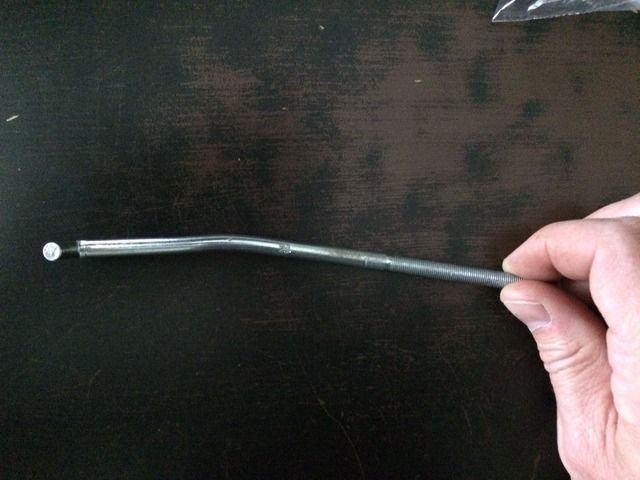

Mike, Bellcrank stud has a split lockwasher on back side. Remove it as it's not helping your alignment issue. You also might want a stronger accelerator return spring.
Air meter to bellcrank rod. Make sure the threads sticking out from the rod are not hitting the 1/4" vacuum line aka main signal line.
Looks awfully close.
You seem to have a lot of clearance between the distributor vacuum advance line and the threads sticking out from the top of the air meter to bellcrank rod. That's nice but on a resto that sometimes is an issue to get enough clearance. You have an extreme amount. Removing the split lockwasher will help.
