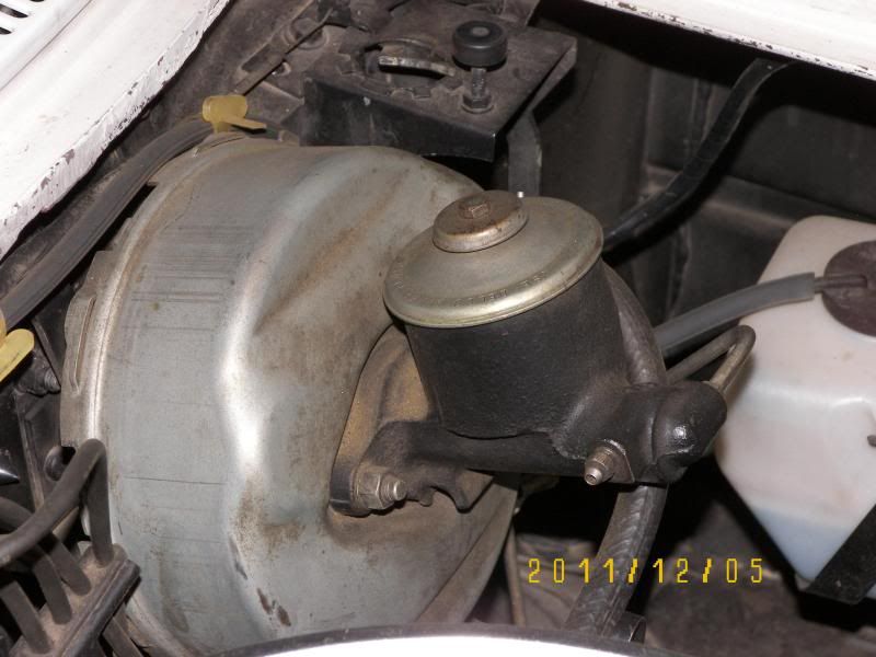

              I don't understand why the attitude of the MC matters and my experience has been that it doesn't.
              Here is the angled MC on my '63. Last time I rebuilt the brakes on this car I was blissfully ignorant of the necessity of bench bleeding the MC. So, I didn't do it. And it hasn't mattered. The car has a firm pedal and stops readily.
              • Jim D.
                • 2885
                Re: Is it necessary to bench bleed master cylinder?
                I wonder if it has something to do with a single circuit M/C with the outlet at the end of the piston vs. a dual circuit M/C with side outlets. I've never had to bench bleed a single circuit M/C but found that with dual circuit ones, it's almost impossible to get a firm pedal without doing it.

                  • Steve G.
                    • November 24, 2014
                    • 411
                    As I said in my earlier post, it's only where the line comes off the side and is not at the very end of the bore. With your cyl tipped up the line passage is still the highest point. Can't trap air,
                    But in this case
                    if the mc is tilted up there is a space in the end of the bore that would be higher than the line coming off (circled in red). Air will trap there. This is often the case with dual circuit cyls.
                    Steve
