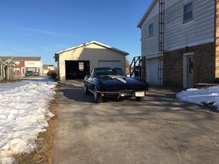

        I agree with David and keith , Only Big Block, A/C, and auto got the offset, and probably not all of them ! It was on the Drivers side and looked something like this
        CORVETTE LICENSE PLATE BRACKET - FRONT 427 WITH AUTOMATIC AND AIR CONDITIONING

          Thanks guys,
          I was aware of when they did it and why, I have that car, but there is not a plate bracket, or holes for that matter on the car/bumper. That is why I asked for pictures of the bracket and how it was mounted.
          I do not have a 67 AIM yet. My guess is there is a page in there on it, but a real picture sometimes is a more clear.
          For some reason I was under thew impression it was on the passenger side, but according to your picture I was wrong about that.
          Thanks for the input guys.

            It mounts the drives side bumper bracket that comes through the grill. There is a drawing intge AIM under RPO C60 with dimensions on where the holes go. Can you tell us more about your car. Big block auto and AC is a rare combo I just got done restoring the black one in the picture this spring.
