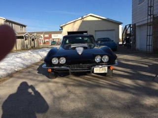

                                Guys: Thanks for all the help. Got it installed after loosening the front bumpers. Looks great especially with the NOS 1966 Texas tag.
