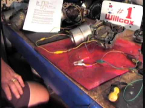

      Apparently wiper motors are ground that angels fear to tread on around here. I am working through an issue myself on my 63 wiper motor. On a tip from one of my chapter members last Saturday (thanks Dallas), I was made aware of YouTube Videos posted by Willcox Corvette on the subject of wiper motor troubleshooting. I've been able to sort through my problem thanks to these videos and my shop manual. I plan to expand on my solution back in a thread I started a few days ago.
      Perhaps you can find some help here as well...
      If I were you though, I would start with a phone call to the person who restored your motor. Diving right into it may void any kind of an warranty provided with the rebuild.
