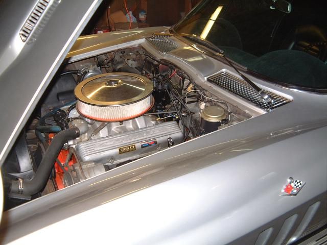

        As I was stripping the driver side fender I found the patch for what must have been an alarm key on/off switch
        Don

          Here's a pic of a 66 Coupe I used to own. Notice the prominent alarm key-switch located above the fender flags.
          Mike T. - Prescott AZ.

            Re: What are these switches?
            The patch I found today was just above the gills. Nice round patch.
