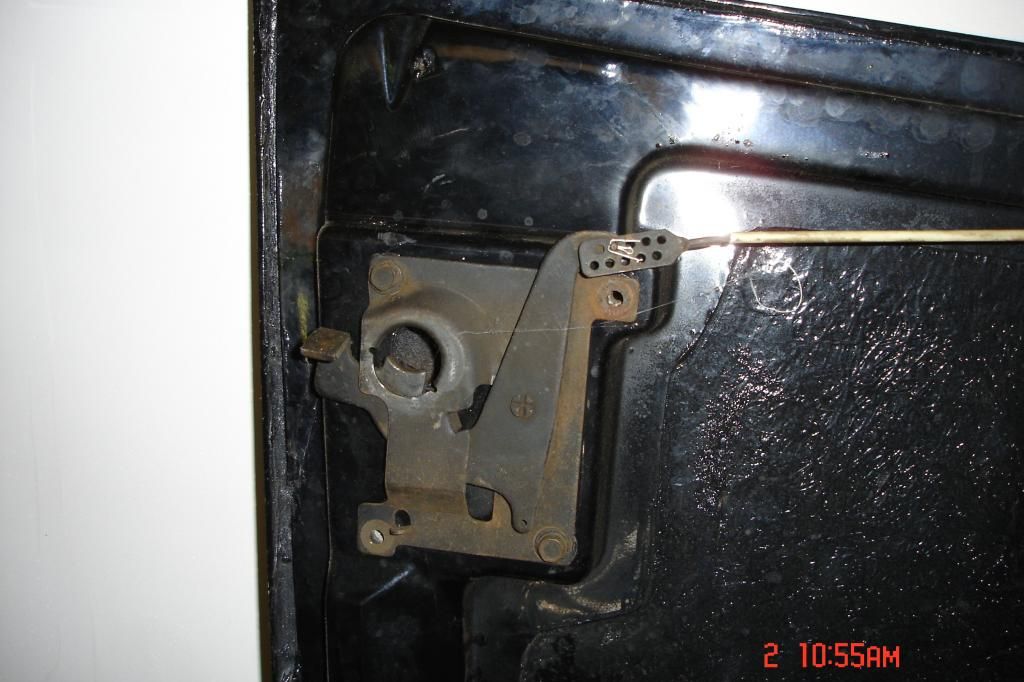

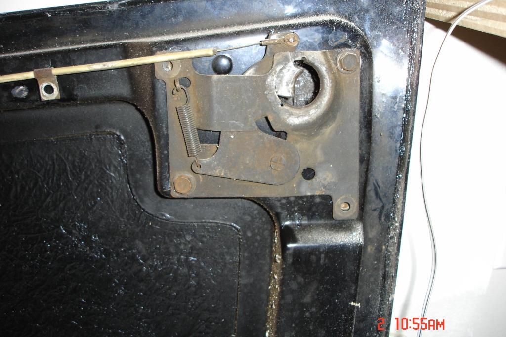

                          I am sorry Patrick I should have explained better. These are my existing latches. Trying to determine if they are right. The new hood has no hardware. My hood in the pictures is from Eckler.
                            • 43246
                            Re: 69 S/B Hood
                            Originally posted by Roger Dinunzio (60097)
                            Roger-----
                            These latches and cross-cable are the 1968-E69 style. There should be TWO retainers with bolts that align and support the cross cable. These bolts thread into nuts "embedded" in the fiberglass (actually a nut plate behind the fiberglass, I think). So, the hood you purchase should have the same TWO embedded nuts.

                              Re: 69 S/B Hood
                              Roger-----These latches and cross-cable are the 1968-E69 style. There should be TWO retainers with bolts that align and support the cross cable. These bolts thread into nuts "embedded" in the fiberglass (actually a nut plate behind the fiberglass, I think). So, the hood you purchase should have the same TWO embedded nuts.
                              Great , at least the latches are good for my E69. I will make sure I can see the retainers before I drive 7hrs.Thanks Joe and everyone else.Roger
