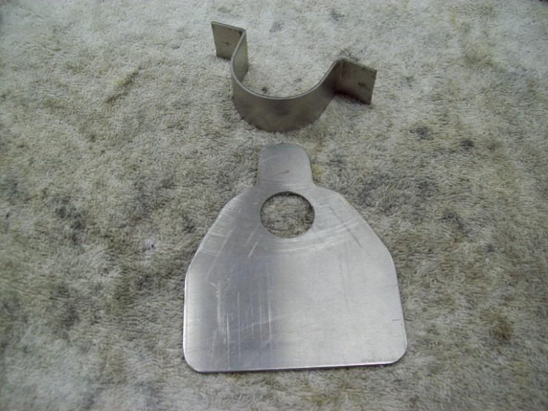

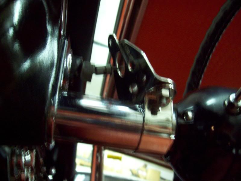

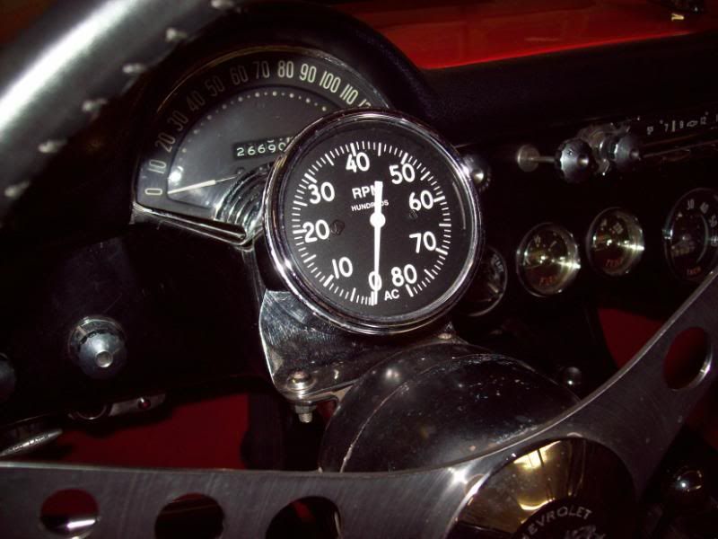

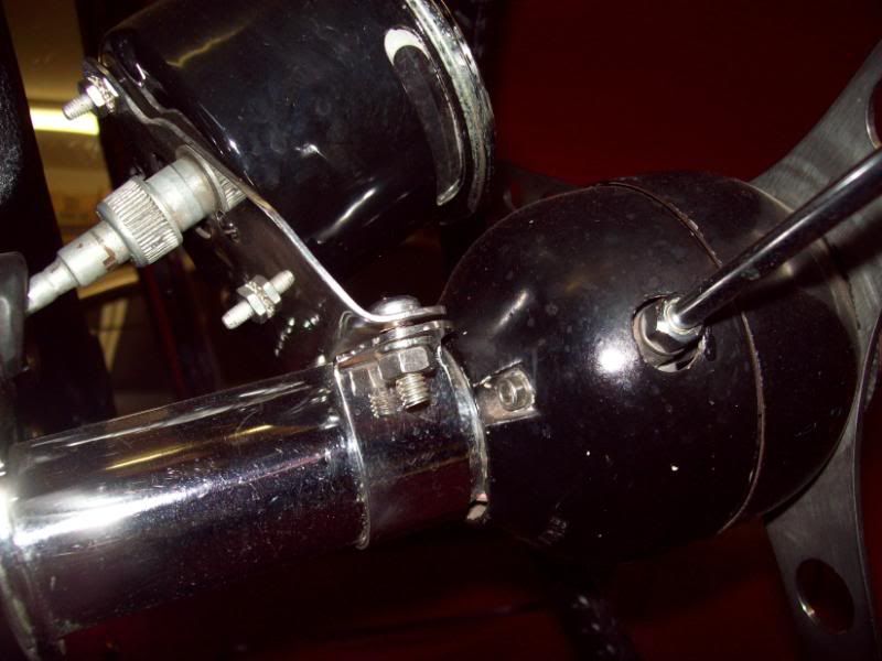

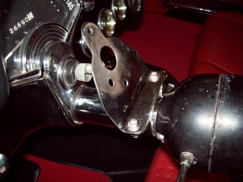

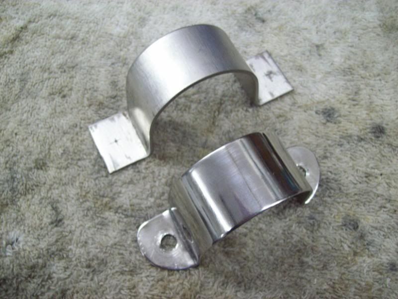

    I have no clue, but I made my own for my 56. It is driven by a 65 FI distributor (and I retained the tach in the dash that is driven by the generator).
    I borrowed an original column mount tack bracket (both pieces) from a friend and traced out a flat pattern on paper. Then I scrolled the pattern onto a piece of sheetmetal (I used stainless, but regular sheetmetal will work fine), cut it out, drilled and shaped the holes and it fits fine.
