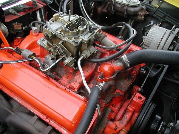

          • 11653
          Re: Anyone recommend engine block paint
          Agreed.
          Below see a photo of the engine in my 1972 with 61,000 miles. virtually everything original (except tires, exhaust, belts and filters), just aged.
          To date it has 3 Top Flights (Chapter, Regional, National) and a 5 Star Bowtie.
          If your 71 is as original as you say it is, just leave it alone. I fully realize the temptation to paint the motor, but I know that in my case it's not going to happen.
              Thanks for the comments and suggestions. Your motor looks good to me! I haven't cleaned mine yet and I know it will look better once I get a little grim off. Mine is a tad dirtier but like I said...I haven't cleaned it yet.
              What is the best way to clean 37 years of grime, oil, grease and sludge?
              Thanks again for the photo....that helps me a lot.
              Greg
