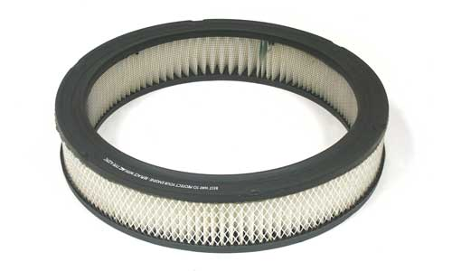

                          Re: A329C repro picture
                          Here is a pic borrowed from a restoration parts catalog.
                          I'll try for a better pic later.
                          Note:
                          - white paper with no oil or yellowing
                          - different metal mesh ("punched diamond holes" in metal)
                          - smaller, different shaped font
                          As noted previously, it's nothing but a current day 329 with a poorly executed "BEST WAY TO ..." silkscreen. I note that the price is currently $10 less than it was 4 years ago to a current $15. Still twice its real value.
                          Patrick
