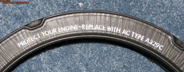

                        Dave,
                        As promised previously, here is a picture of the embossed words on my filter:

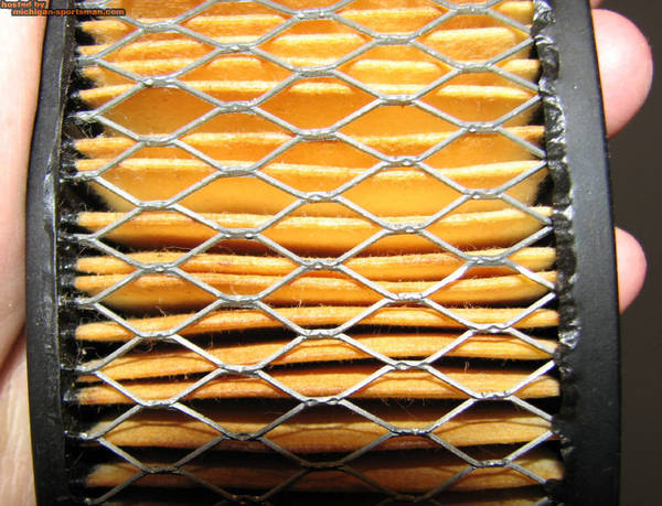

                        And here is a picture of the wire:
                        I show them only for discussion purposes as I am not sure how correct this filter is in all areas. I "think" it is close with the exception of missing the "BEST WAY TO" lettering. To the best of my knowledge this is a filter from the 74-75 era, but I am open to corrections.
                        The currently available repro is not at all accurate. It is nothing more than a current day off-the-shelf 329 with the "BEST WAY TO ..." words embossed in much smaller incorrect font. It is not made by Paragon, but they do sell it.

                          Patrick
                          Could you repost your embossed filter picture ? I think you showed the reproduction filter with the silk screen printing.

                            Patrick,
                            I don't see embossing just the silkscreen. It is an obvious repro to me. Look at the hundreds of lines connectint the inner and outer rubber lines. Yours has the expanded metal mesh which may or may not be right. I'm not sure.

                              Dave
                              Patricks picture is of a filter that was made after the square mesh and was a service repacement made after 1975 which may be the last year a 329 was used on Corvettes. If your filter has the font of the silk screen in Particks picture and square mesh with the best way you have the correct filter I think without seeing a picture. Next best is the same filter with no best way. The third would be the one in Patricks picture. The fourth would be the one sold by vendors with the small printing and expanded metal. Tied for fourth would be the last service replacement that said only GM and the part number with expanded metal.
                              The only way I can explain this better is to take a picture of each as I have all of them but not that reproduction.
