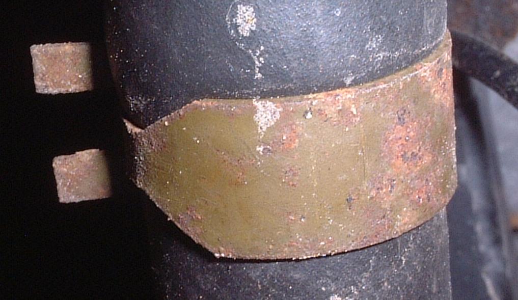

                    This pic is of 17XXX PCV clamp; original?

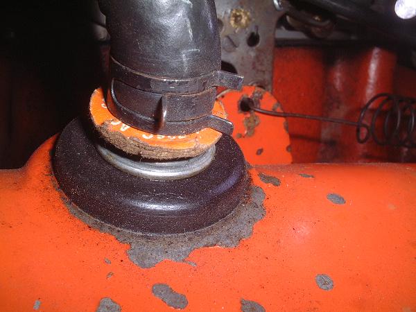

                      Re: 67 hose clamps for PCV hose and fuel hose
                      I believe this may be an untampered fuel tank line clamp, circa mid '67 installation.

                        Nick - Happy NY. What is the configuration of the end of the center tang, squared or rounded? Pete
                        • Nick Culkowski
                          #27
                          Pete, Happy New Year to you, and to all members... Looks like the shadow detail got lost when I resized the photo. The end of the center tang on the fuel line is square and the same lenghth as the outside tangs. The pcv clamp center tang is rounded.
                            Hi Nick:
                            Thanks for the photos. I think I now understand what both the PCV clamp and the fuel hose clamp should look like for 1967.
