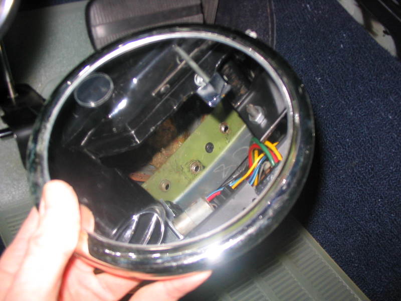

          • Ronnie Robertson # 36786
            Isn't curiosity a terrable thing...
            I took my release bracket off and Randy is correct in all aspects. As to Jeremy's question, my (#147...) plate holding the nuts IS riveted on with a single rivet in the center (See photo).
