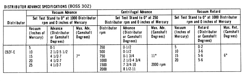

          1) You will need a vaccum source with extreme accuracy, i.e., can be set to 1" increments.
          2) To do the centrifugal part in the car, if I remember right, you'll have to check it at 4000 or more engine rpm, something that always makes me nervous. I would yank the thing and take it to a pro.
