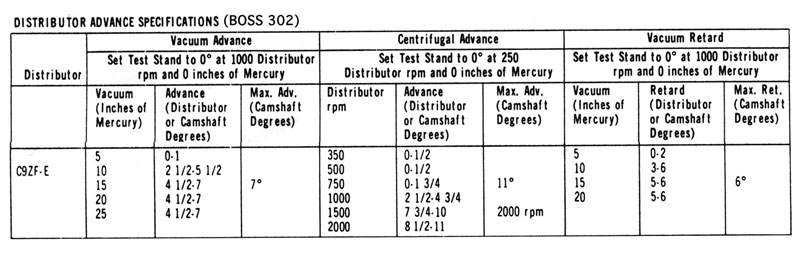

                          Dave, when I get my 390/427 going again. I plan on checking the advance curve. Since it is not modified, I plan on looking at the information that describes the advance curve in the back of the overhaul manual. My question is, I assume I can just hook up my electronic tack and watch the advance with a timing light at the flywheel to determine if all is well?? It is my understanding that during part of this procedure, I will need to disable the centrifugal mechanism to only observe part of the curve. Any light that can be shown on this would be appreciated. Thanks, tErry
