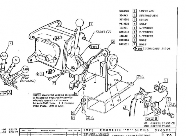

                      The shifter mount (2) on a stock corvette does not mount to the trans.
                      Here is a pic of a 73 mount.
                      Hope this helps.

                        That looks like the 1969 drawing EXCEPT 1969 has no view A or view B and no NOTE either.
                        BTW: The note, which IIRC is not in the 1970 AIM, says it all.

                          Terry, it was a very common practice for the drafting graphics group to cut and paste part or all of the illustration from one MY to the next. They just added to or subtracted whatever was necessary and put it on the next model years AIM format.
