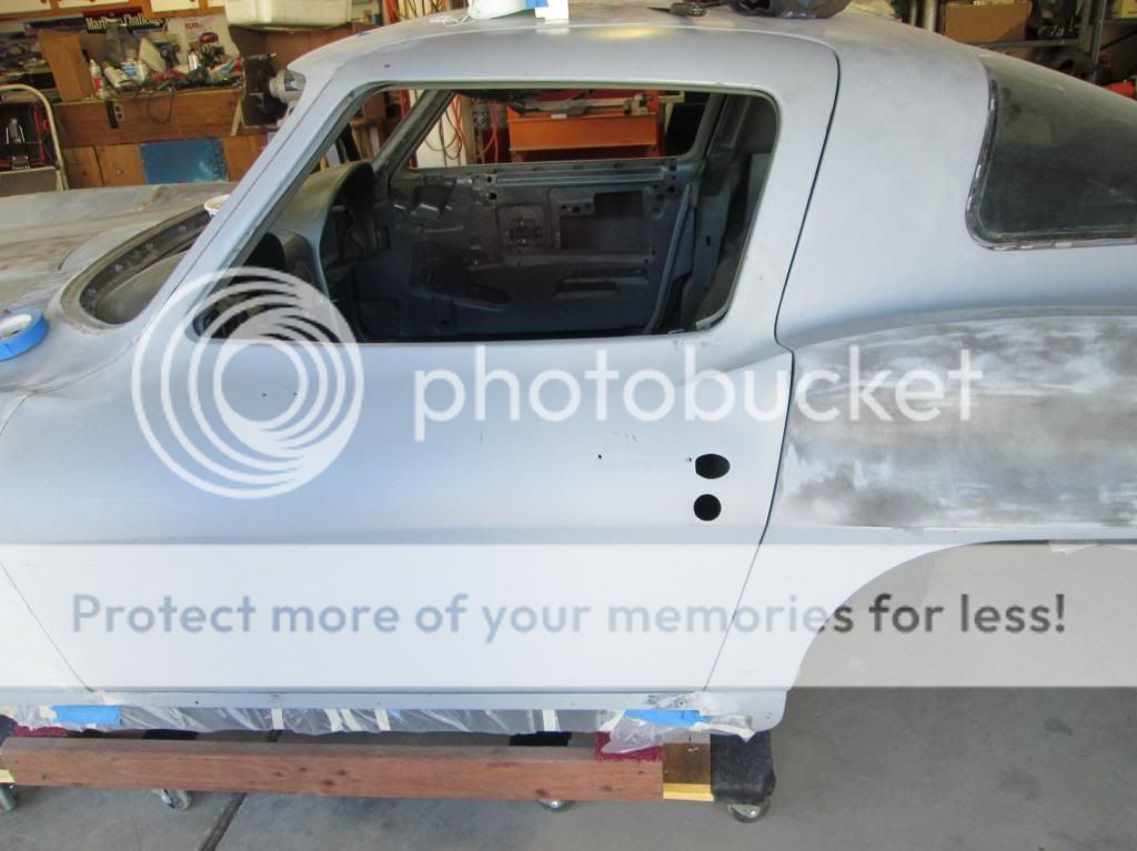

              Hi Joe, you didn't mention how much you want to reduce the gap. Hopefully it's not that big. The 1970's body shop that did my 67's front end left the front hood gap with a 3/8ths difference from one side to the other. I ended up cutting the fender off and doing it correctly.
              I'm with Phillip, use resin and glass. Then use good filler, certainly not the Bondo brand. use the Vette Panel, Evercoat Rage or U-Pol Gold. Personally , my limit on body filler is 1/32ond, anything thicker is done with glass, but that's just me.

                  I had an issue with the gap on my left door on my 63. Matte & resin were used on BOTH sides of the door to extend it a little, so that the gap could be achieved. It's the harder way, but as far as I'm concerned, the only right way. Bondo was never an option with this particular issue.

                    Exactly Gary, bondo for pin holes . After I finished fixing my hood gaps, the door gaps were next (with glass & resin).
