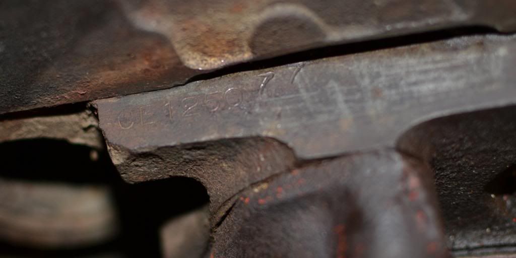

            Here's an ugly looking CE stamp. Did they gang stamp the CE, year designation, and first three digits after casting, then add the last two digits at the time of the build-out?

              Peter -
              Only the first few characters after the "CE" were in the gang holder - it's quite common to see the last two or three characters stamped individually.
