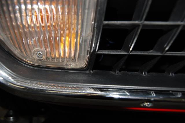

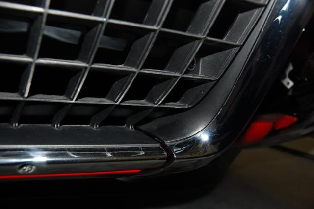

                        • Bill L.
                          • February 1, 2004
                          • 1403
                          Re: 1970 Front Grill Restoration
                          There was a thread somewhere that suggested pressing the front of the grilles lightly in to foam and to paint them from the back. The reason I preferred this method is I thought the lines on the front did not look like hard lines as the grilles were cleaned up. They actually showed what I will call paint fogging. Using this method seemed to duplicate the factory spray pattern perfectly. I did a little touch touch up with a razor and lacquer thinner afterwards.
                          I did all the other paint work on the grilles before using the foam. Painted the black detail first. Carefully taped off the black detail and painted the lower rows that had no chrome exposed. At this time I taped the chrome surround and sprayed the front except for the rows with chrome edges exposed. Once this cured for a couple weeks I turned them over, pressed them in to the foam and sprayed. The nice thing about the lacquer is I could spray until the desired coverage was obtained.
                          It was a pretty tedious but very rewarding experience. Now my chrome was in very nice shape with no pits. It does show some wear but nothing worth re-chroming at this point. I especially did not want to risk the original 70 only grills which are rarer then hens teeth these days.
                          I was able to have a local shop mix up the original lacquer formula including the texturizer (is that a word?)
                          Here is a pic albeit not a very good one. IMG_0035.jpg IMG_0034.jpg There are a few water spots that were not cleaned off the egg crates. Color sanded a little and some water got on the grilles.
                          Bill
