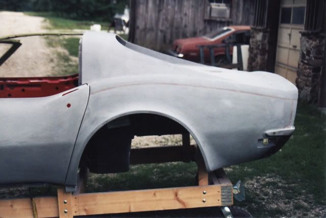

        Blair: When I stripped a late 69 convertible built July 69, it was all dark gray (grey?) glass that looked the same as a 67. When I stripped a late 70 coupe built July 70, it had white doors but the rest was dark gray like the 69. The dark gray glass (which looks almost black as an NOS panel before it is sanded) is made with polyester resin. The white glass I believe is called SMC (sheet molded compound) and is made with epoxy resin. I think by 1975 all the panels of a C3 were white SMC but I don't know when they were phased in. What year car are you concerned about?

          Here are a few photos to show the difference. The first are the dark or polyester fiberglass second are SMC fiberglass. All are over the counter service parts.
