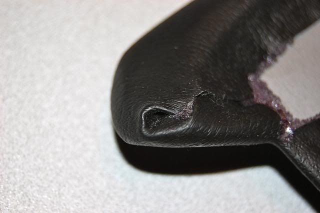

        Hi Cal,
        I agree that the quality and craftsmanship of the soft parts wrapped with vinyl isn't always very good.
        Even from a good manufacturer you need to examine EACH piece closely. The workmanship varies from piece to piece.
        Here's the top of an a-pillar trim piece. The defect is visible when the part is installed.
        On the original trim piece this corner of the vinyl is 'stretched' and trimmed in such a way that there is no 'buckle' visible

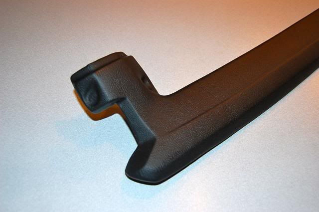

        Looks good:
