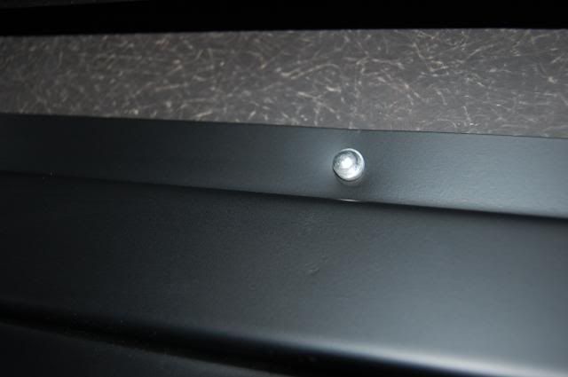

                      You will need to do one final step to finish the tail of the rivet to look like GM's rivet. GM's rivet tail finish is rounded. Compare the rivet tail in the video and the rivet tail in Alan's picture in post #7. To finish off the tail of the rivet I use a round head rivet set and gently drive it in reverse using the bucking bar on the head of the rivet and drive the tail of the rivet using the air hammer with the round head rivet set (I think i us the round head rivet set for 1/8" or 3/16"for this). You don't want to be over zealous in this last step.
