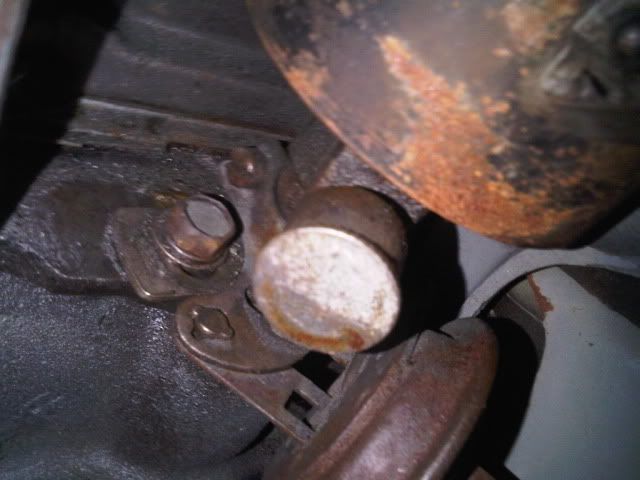

    Hi Troy & Eric - i still can't get my head around this. Your picture looks just like what i have and i have crawled under the car to see if something is missing but i can't tell. You mention a clamp around the shaft - would you happen to have a picture of this? My dizzy moves approximately an 1/8 inch in a clockwise direction and when i let go it springs back (anti clockwise) i simply cannot see where something would fit to lock it down, it does not look like i'm missing anything.

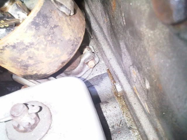

      The "gizmo"/clamp that we're talking about is called an octane selector. You could fine tune the timing using the hash marks aligning them with the scribe on the engine stamp pad. Here are some pics from a regular old 235 Chevy 6 cylinder. Same set up. Only difference is that the distributor doesn't have a tach drive.

        Hi Chuck, thanks for the pics. they have eliminated any guesswork about missing parts! When i tighten the screw closest to the block at the base of the shaft (in your first pic) the distributor still moves approx 1/8 inch maybe a bit more. Is this normal? i wouldn't have thought so.

          When you say "moves", does it rotate clockwise/counterclockwise 1/8" OR can you push it fore/aft/lt/rt (12:00 o'clock to 6:00 o'clock, 3:00 o'clock to 9:00 o'clock) 1/8" ? Chuck

            Rotates clockwise/counterclockwise -

              If you look at the vacuum canister, best seen in the second picture, you'll see that it is attached to a plate ABOVE the mounting bolt. (the bolt to the block) The vacuum advance will allow the entire distributor body to rotate counterclockwise. If you rotate it CCW, it should spring back to the initial timing setting. Chuck

                The movement of your distributor is normal. So that is not the problem. In your first notification of the distributor movement you didn't mention that it springs back. Key info.
