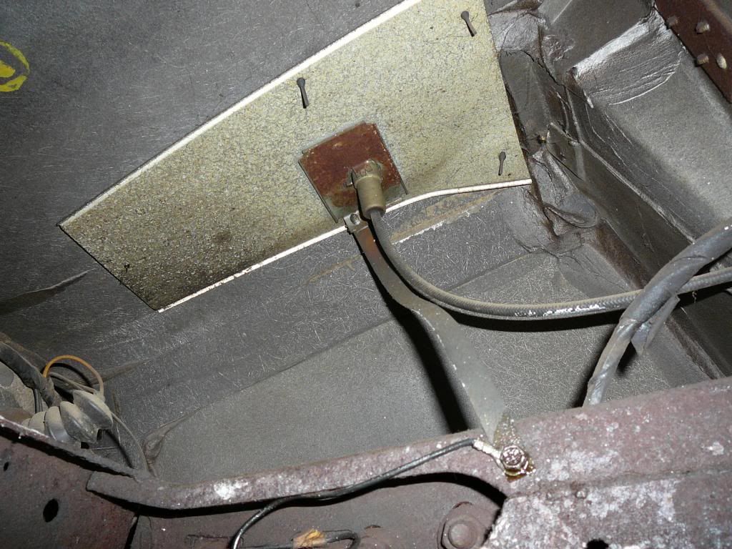

    I am getting ready to bolt up the plate. What does the washer look like. Mine did not have one when disassembled.
    Same washer on both ends of strap?
    How is the strap routed?
    I saw some pics of a C2 but could not find any on C3.
    Bill

    The washer is a special "grounding washer". It has BOTH external and internal teeth. It is 17/64" ID and 11/16" OD and is zinc plated. The same washer is used at all positions.

      Thank you as always Joe. I found an original in my box based on your description. It is just bigger than the bolt which gave me reason enough to pose the question.
      Any thoughts on the routing.
      Bill

        Re: 70 antenna ground strap washer and routing

          Thank you Mike. That is how I did mine.
          Now I just have to pick up some correct washers. Luckily they are readily available.
          Bill
